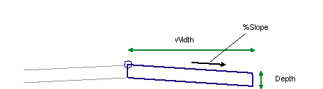

This subassembly creates a simple lane.
This subassembly is one of a group of Getting Started subassemblies used for simple carriageway modeling, and for tutorial and training purposes.
The attachment point is at the inside edge of lane on finish surface.

Width
Width of the lane
Numeric, positive
3.6 m
12.0 ft
Depth
Depth from finish surface to subbase
Numeric, positive
0.2 m
0.67 ft
%Slope
% Slope of the lane
Numeric
-2%

Behavior
The subassembly builds a finish surface and subbase surface, closed by vertical links at either end. The lane is inserted outward from the attachment point for the given width, depth, and slope.
Layout Mode Operation
In layout mode, this subassembly draws the lane using the input parameters.
