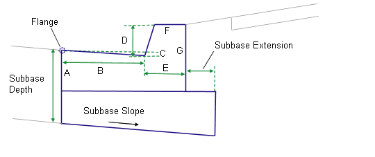

Dimension A
(mm/in)
Depth of the channel at the flange point
Numeric, positive,
non-zero
175 mm
7 in
Dimension B
(mm/in)
Width from the flange point to the channel invert level
400 mm
16 in
Dimension C
(mm/in)
Depth from the flange point to the channel invert level
Numeric, positive,
non-zero
25 mm
1 in
Dimension D
(mm/in)
Height of kerb from the channel invert level to the top-of-kerb
Numeric, positive,
non-zero
150 mm
6 in
Dimension E
(mm/in)
Width from the channel invert level to the back-of-kerb
Numeric, positive,
non-zero
200 mm
8 in
Dimension F
(mm/in)
Width of the top-of-kerb
Numeric, positive,
non-zero
150 mm
6 in
Dimension G
(mm/in)
Height of the back-of-kerb
Numeric, positive,
non-zero
325 mm
13 in
Behavior
The kerb and channel links are inserted based on the Input Parameter dimensions Dimension A – Dimension F. All dimensions must be positive, non-zero values. If a non-zero subbase depth is given, the subbase layer is inserted to the back of kerb, and continues for the Subbase Extension width. The subbase layer closes to the bottom-back-of-kerb, as shown in the diagram.
The subassembly builds the shape for a simple kerb and channel, with the attachment point either at (a) inside edge of the channel (or lip), or (b) the back of the kerb. The face of the kerb is given a small, constant width to make it non-vertical.
