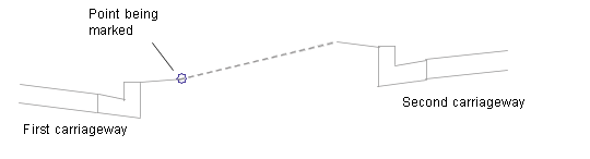

In the example below, there are two carriageways with independent profiles. Once the links for the first carriageway are created, the point at the left outside edge is being marked. Later, after the links for the second carriageway are created, a link can be inserted from its right outside edge back to the marked point.

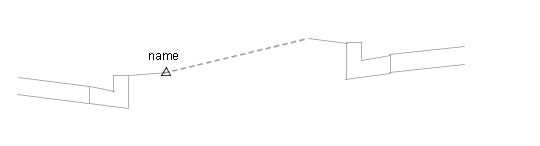

Layout Mode Operation
In layout mode, this subassembly draws a triangle symbol at the location of the marked point, and labels the marked point name above the point.
