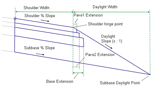

Behavior
The finish surface of the shoulder is inserted for the given Shoulder Width and Shoulder % Slope outward from the attachment point, and the subbase link is inserted from the attachment point offset starting at the Subbase Depth below the finish surface.
The shoulder daylight link can be inserted with either a fixed slope (Hold Daylight Slope = True) or a fixed width (Hold Daylight Slope = False). If a fixed slope is used, the daylight link is extended from the outside edge of shoulder until it intersects the subbase link. Otherwise the subbase layer is extended for the Daylight Width beyond the outside edge of shoulder, and the daylight link is connected to the end of the subbase.
The Pave1, Pave2, and Base surface links are inserted parallel to the finish surface at the given depths. If the layer Extension values are non-zero, each layer is extended for the given distance beyond the shoulder hinge point. If a layer extends past the daylight slope, the layer is terminated at the daylight slope intersection. Each layer should be as wide or wider than the one above it.
Layout Mode Operation
In layout mode, this subassembly displays the links comprising the shoulder for a normal crossfall carriageway situation. If numeric slope values are given for the Shoulder % Slope and Subbase % Slope, the links are shown at the given slope values. Otherwise the default slopes of -6% are used.

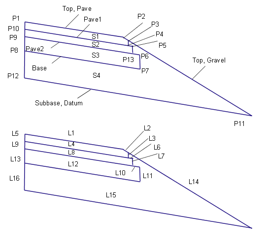

Point, Link, and Shape Codes
The following table lists the point, link, and shape codes for this subassembly that have codes assigned to them. Point, link, or shape codes for this subassembly that do not have codes assigned are not included in this table.
Type
Code
Description
P2
EPS
Edge of paved shoulder, finish surface
P4
EPS_Pave1
Edge of paved shoulder on Pave1
P13
EPS_Pave2
Edge of paved shoulder on Pave2
P7
EPS_Base
Edge of paved shoulder on Base
P11
Daylight_Sub
Subbase daylight point
L1, L2
Top, Pave
Paved finish surface
L4
Pave1
L8
Pave2
L12
Base
L15
SubBase
Datum
L14
Top, Gravel
Unpaved finish surface
Other Links
As shown below
S1
Pave1
S2
Pave2
S3
Base
S4
SubBase
Coding Diagram
