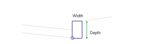

This subassembly creates a simple kerb at the edge of carriageway. It can be attached to either outside edge of pavement or to the edge of a central reserve on the inside.
This subassembly is one of a group of Getting Started subassemblies used for simple carriageway modeling, and for tutorial and training purposes.
The attachment point is on the front face of the kerb for case 1, and on the back face of the kerb for case 2.

The subassembly builds a rectangular shape for a simple kerb, with the attachment point at the bottom inside edge of kerb.
Layout Mode Operation
In layout mode, this subassembly draws the kerb shape as specified by the input parameters.
