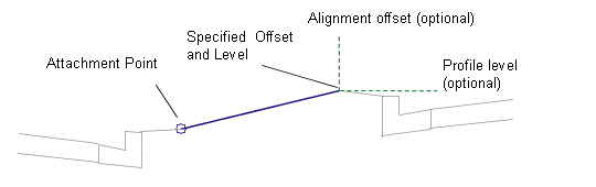

LinkOffsetAndLevel
This subassembly is a general purpose utility to connect a link from the attachment point to a specified offset and level.
An alignment can be substituted for the offset, and a profile for the level.
The attachment point is at the beginning of the link. The direction of the link is determined by the location of the given offset and level relative to the attachment point.

Behavior
A link is added from the attachment point to the given offset and level.
Layout Mode Operation
In layout mode, this subassembly displays a horizontal link using the given Offset input parameters as the width.
Point, Link, and Shape Codes
None.
Coding Diagram
