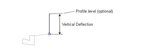

This subassembly is a general purpose utility to add a vertical surface link by vertical deflection.
A profile can be used when building a corridor model to allow variable vertical deflection.
The attachment point is at the inside edge of the link. This subassembly can be inserted in the left or right direction from the attachment point.

Behavior
A vertical link is added from the attachment point for the given vertical deflection. If a profile name is given for the Vertical Deflection, the end of the link will match the profile level.
