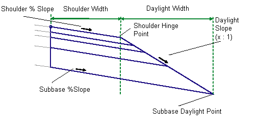

ShoulderExtendAll
This subassembly inserts a paved shoulder with all pavement, base, and subbase layers extended to the shoulder daylight slope.

Behavior
The finish surface of the shoulder is inserted for the given Shoulder Width and Default Shoulder Slope outward from the attachment point. The subbase link is inserted from the attachment point starting at the Subbase Depth below the finish surface.
The shoulder daylight link can be inserted with either a fixed slope (Hold Daylight Slope = True), or a fixed width (Hold Daylight Slope = False). If a fixed slope is used, the daylight link is extended from the outside edge of the shoulder until it intersects the subbase link. Otherwise, the subbase layer is extended for the Daylight Width beyond the outside edge of the shoulder, and the daylight link is connected to the end of the subbase.
The Pave1, Pave2, and Base surface links are inserted parallel to the finish surface at the given depths until they intersect with the shoulder daylight link.
Layout Mode Operation
In layout mode, this subassembly displays the links comprising the shoulder for a normal crossfall carriageway situation, using default shoulder and subbase crossfall.

Note:
L14 is the new link connecting P2-P10 or P2-P8 or P2-P6 or P2-P4, depending on which is the lowest link.
Coding Diagram
