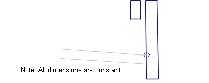

This subassembly creates a simple guardrail shape on the assembly.
This subassembly is one of a group of Getting Started subassemblies used for simple carriageway modeling, and for tutorial and training purposes.
The attachment point is at the inside edge of the post at finish surface level.

The subassembly builds two rectangular shapes for the post and railing. The dimensions are fixed, and cannot be changed by the user. The post extends downward from the attachment point for a fixed distance below finish surface.
Layout Mode Operation
In layout mode, this subassembly draws the post and rail with the fixed dimensions.
