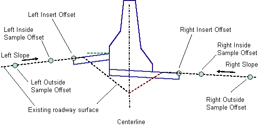

This subassembly widens an existing divided highway by extending from the travel lane edges inward over a depressed central reserve, with an asymmetrical barrier at the centerline to resolve level differences. It includes an option to tie the top-of-barrier level to a predefined profile.
The attachment point is the center of the base of the barrier.

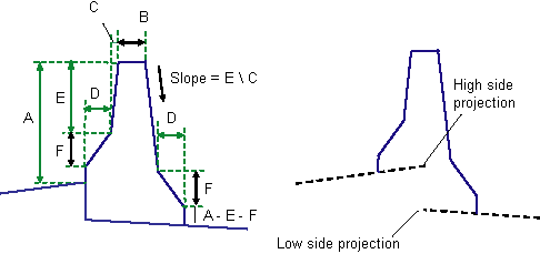

Dimension A (mm or inches) |
Height of the barrier from the base on the high side of the central reserve to the top of the barrier. |
Numeric, positive |
810 mm 32 in |
Dimension B (mm or inches) |
As shown in diagram. |
Numeric, positive |
232 9 in |
Dimension C (mm or inches) |
Numeric, positive |
59 mm 2 in |
Dimension D (mm or inches) |
Numeric, positive |
125 mm 5 in |
Dimension E (mm or inches) |
Numeric, positive |
557 mm 22 in |
Dimension F (mm or inches) |
Numeric, positive |
178 mm 7 in |
This section lists the parameters in this subassembly that can be mapped to one or more target objects, such as a surface, alignment, or profile object in a drawing. For more information, see in the AutoCAD Civil 3D User’s Guide Help.
Parameter |
Description |
Status |
Existing Surface |
Name of the Surface defining the existing carriageway. The following object types can be used as targets for specifying this surface: surfaces. |
Required |
Top of Barrier |
May be used to tie the top of barrier to the level of a profile. Dimension E may vary to achieve the calculated barrier height. The following object types can be used as targets for specifying this level: profiles, 3D polylines, feature lines, or survey figures. |
Optional |
Left Insert Offset |
May be used to calculate the offset of the left insert point from an alignment. The following object types can be used as targets for specifying this offset: alignments, polylines, feature lines, or survey figures. |
Optional |
Left Inside Sample Offset |
May be used to calculate the offset of the left inside sample point from an alignment. The following object types can be used as targets for specifying this offset: alignments, polylines, feature lines, or survey figures. |
Optional |
Left Outside Sample Offset |
May be used to calculate the offset of the left outside sample point from an alignment. The following object types can be used as targets for specifying this offset: alignments, polylines, feature lines, or survey figures. |
Optional |
Right Insert Offset |
May be used to calculate the offset of the right insert point from an alignment. The following object types can be used as targets for specifying this offset: alignments, polylines, feature lines, or survey figures. |
Optional |
Right Inside Sample Offset |
May be used to calculate the offset of the right inside sample point from an alignment. The following object types can be used as targets for specifying this offset: alignments, polylines, feature lines, or survey figures. |
Optional |
Right Outside Sample Offset |
May be used to calculate the offset of the right outside sample point from an alignment. The following object types can be used as targets for specifying this offset: alignments, polylines, feature lines, or survey figures. |
Optional |
None.
The left and right slopes are calculated between the sample points on each side. Lines from the cutout points are extended inward at these slopes to the centerline. The side with the highest level at the centerline determines the controlling side for the minimum height of the barrier.
The offset of the barrier base on the high side is calculated from the given dimensions. The overlay layer on the high side is extended from the cutout point to this offset.
The overlay layer on the low side is extended from the cutout point to the offset of the barrier base on the high side.
The barrier is constructed from the base point on the high side, closing to the top of the overlay layer on the low side, as shown in the diagram.
If a top-of-barrier profile is given as a target parameter, the height of the barrier is controlled by the profile. Dimension E may vary to achieve this height.

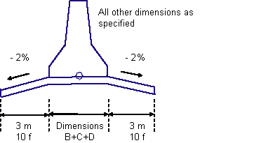

In layout mode, a symmetrical central reserve and barrier are drawn with the fixed dimensions shown below. This is the same figure that is drawn in layout mode for the OverlayCentralReserveSymmetrical subassembly.
