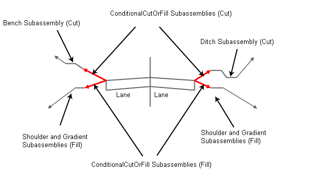

The following illustration shows a corridor assembly section comprised of:
