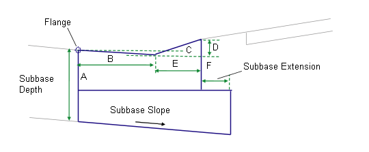

Behavior
The kerb and channel links are inserted based on the Input Parameter dimensions Dimension A – Dimension F. All dimensions must be positive, non-zero values. If a non-zero subbase depth is given, the subbase layer is inserted to the back of kerb, and continues for the Subbase Extension width. The subbase layer closes to the bottom-back-of-kerb, as shown in the diagram.
The subassembly builds the shape for a simple kerb and channel, with the attachment point either at (a) inside edge of the channel (or lip), or (b) the back of the kerb. The face of the kerb is given a small, constant width to make it non-vertical.

In layout mode, this subassembly displays the kerb-and-channel component based on the input parameters given. If the Use SE parameter is set to true, the subbase layer is inserted at a slope of -2%.
