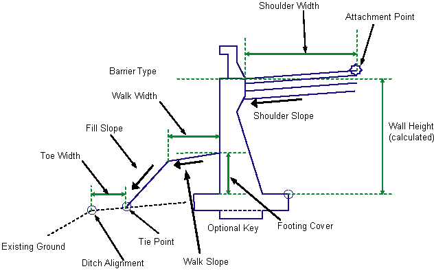

This subassembly inserts a retaining wall structure with a paved shoulder and with special tie slopes to tie to an existing ditch.
This subassembly can place an optional barrier on the top of the wall and an optional key below the footing.
The attachment point is on the inside of the shoulder.

Wall height is determined from top of the footing to attachment point of ground level on the vertical face, whichever is higher. Wall battered slope, width of the footing, offset of wall vertical face, optional key dimensions, and the location of the key center are all functions of the wall height.

This subassembly can be inserted either on the left or the right sides. The attachment point is assumed to be at the design edge of carriageway, from where the paved shoulders will be drawn as specified by this subassembly.
The top-of-footing level is determined by working inwards from the Tie Point to the inside edge of walkway, then subtracting the Footing Cover from the tie link at the offset of the outside footing corner. The height of wall (H) is calculated between the Outside Edge of the Shoulder and the top of footing. If the Key option is set to No, then the base of the footing is a single horizontal link. If the Key option is used, links to define the optional key are inserted.
Note: A very small gap (0.001 for m) is left between the pavement layers and the inside face of wall. This is to facilitate material analysis using the quantity takeoff feature, as shown in the detail below.
In layout mode, the subassembly draws the retaining wall shape as specified by the input parameter values, assuming that the subassembly is in a fill condition.
