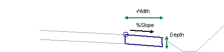

This subassembly creates a simple paved shoulder with finish surface and subbase.
This subassembly is one of a group of Getting Started subassemblies used for simple carriageway modeling, and for tutorial and training purposes.
The attachment point is at the inside edge of the shoulder on the finish surface.

Width
Width of shoulder
Numeric, positive
0.9 m
3 ft
Depth
Depth from finish surface to subbase
Numeric, positive
0.2 m
0.67 ft
%Slope
% Slope of the shoulder
Numeric
-4%

Behavior
The shoulder links are inserted outwards from the attachment point at the given width, slope, and depth.

Point, Link, and Shape Codes
The following table lists the point, link, and shape codes for this subassembly that have codes assigned to them. Point, link, or shape codes for this subassembly that do not have codes assigned are not included in this table.
Point, Link, or Shape
Codes
Description
P2
EPS
Edge of paved shoulder on finish surface
P4
EPS_Sub
Edge of paved shoulder on subbase
L1
Top,
Pave
Paved finish surface
L3
Datum, SubBase
Subbase
S1
Pave1
Coding Diagram
