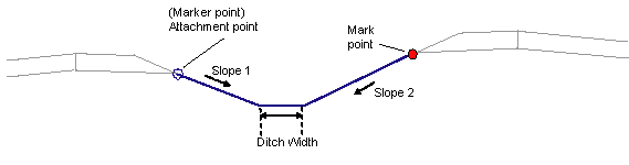

Behavior
The locations of the attachment point and marked point are determined. The marked point may be either to the right or left of the attachment point. Links are extended inward at Slope 1 from the attachment point, and Slope 2 from the marked point, until they intersect. If a non-zero ditch width is given, a horizontal bottom-of-ditch link is fit into the intersecting side slopes.

Finish surface on unpaved shoulder and central reserve links
Coding Diagram
