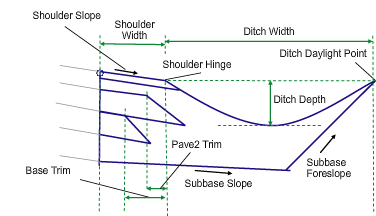

The finish surface of the shoulder is inserted for the given Shoulder Width and Shoulder Slope outward from the attachment point. Then parabolic ditch links are added as a series of 6 links from the end of the shoulder to the specified width, using the ditch bottom depth as low point of the parabola.
Now the subbase link is inserted from the attachment point offset starting at the Subbase Depth below the finish surface, using default shoulder slope (or the superelevation slope). Other end of the subbase is found by drawing a link from the end of the ditch with the subbase foreslope as shown in the illustration.

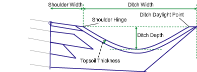

If topsoil material is set with “a positive” value then a new material layer is introduced to the specified thickness right below the daylight link. The thickness is measured perpendicular to the parabolic ditch shape. Top of the ditch is drawn from the shoulder hinge point to the specified width and the ditch depth. On inside edge of the ditch a link offset link is added (along the shoulder link) so that the specified ditch topsoil depth is achieved. Similarly a horizontal link is added on the outside end of the ditch. Now using these two and the topsoil thickness, reminder of the parabolic topsoil bottom is created. Due to this new layer provision, width of the shoulder top layer will be adjusted as shown in the following illustration.
The Pave1, Pave2, and Base surface links are inserted parallel to the finish surface at the given depths. Bottom of the Pave1 link is always extended to the daylight link. If Pave 2 and/or Base Trim values are set to zero value – then the top links of these layers will be extended to the offset of “bottom link of the previous layer”. Bottom links of these layers are extended such that slope of the wedge formed on the side is same as the ditch start gradient (Note: compute the start gradient of the parabolic ditch using three known points of the parabolic equation).
If the above trim values are set for a positive value then top of respective material will be shortened by that value and the bottom link will be derived with material side slope equal to the daylight slope.
