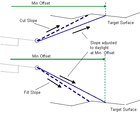

This subassembly inserts a link that daylights to a target surface at a user-defined cut or fill slope.
If necessary, the slope is adjusted to keep the daylight point beyond a minimum offset from the baseline.

This subassembly attempts to calculate a daylight point for the cut condition. If a daylight point is found, its offset is compared to the Min Offset value. If the daylight point is within the Min Offset, the daylight point is moved to the minimum offset point on the target surface. If no cut daylight point is found, the process is repeated for the fill condition.
If an offset horizontal alignment name is assigned to the Min Offset during corridor modeling, the value of the Min Offset will vary to match the offset of the alignment.

In layout mode, this subassembly displays both the cut and fill slopes in dashed lines extended outward for the Min Offset distance. The daylight links are terminated with arrowheads pointing outwards.
