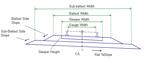

This subassembly inserts the rails, sleeper, ballast, and sub-ballast for a single-track railroad.
It should be followed with a Daylight subassembly on the left and right sides to close to existing ground in cut and fill situations.
This subassembly is designed for visualization and to demonstrate the use of corridor modeling for rail applications. It is not intended for actual engineering production work.

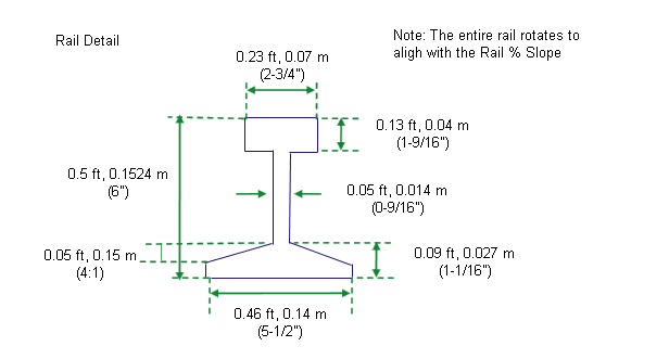

The attachment point is at a distance equal to the rail height above the centerline of the sleeper.
Note: All dimensions are in meters or feet unless otherwise noted. All slopes are in run-over-rise form (for example, 4 : 1) unless indicated as a percent slope with a “%” sign.

The links for the rails, sleeper, ballast, and sub-ballast are calculated and placed based on the input parameter values provided. If the Rail %Slope is non-zero, the corridor profile level is held at the center of the rail on the low side. The finish surface, sleeper, ballast, and sub-ballast links are maintained at the Rail %Slope.
In layout mode, this subassembly displays the links comprising the finish surface, ballast, sub-ballast, and side slopes.

Rail shapes |
Rail |
Not shown in diagram |
