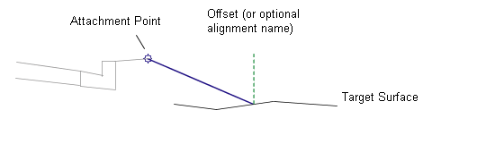

LinkOffsetOnSurface
This subassembly is a general purpose utility to extend a link from the attachment point to a given offset on a target surface.
An alignment can be used when building a corridor model to calculate the offset.
The attachment point is at the beginning of the link.
Input Parameters

Behavior
A link is extended to the point on the target surface at the given offset.
Layout Mode Operation
In layout mode, this subassembly displays the link drawn to the given offset at a -4 : 1 slope. The link terminates with an arrowhead pointing outwards.
