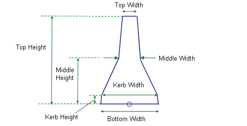

This subassembly creates a two-sided New Jersey barrier on a carriageway surface.

The attachment point is at the center of the bottom of the barrier.
Input Parameters
Note: All dimensions are in meters or feet unless otherwise noted. All slopes are in run-over-rise form (for example, 4 : 1) unless indicated as a percent slope with a “%” sign.
Parameter
Description
Type
Default
Top Width
Width of the top of the barrier
Numeric, positive
0.15 m
0.5 ft
Middle Width
Width of the middle of the barrier
Numeric, positive
0.225 m
0.75 ft
Bottom Width
Width of the bottom of the barrier
Numeric, positive
0.6 m
2.0 ft
Top Height
Height to the top of the barrier
Numeric, positive
0.9 m
3.0 ft
Middle Height
Height to the middle of the barrier
Numeric, positive
0.45 m
1.5 ft
Kerb Height
Height of the barrier kerb
Numeric, positive
0.075 m
0.25 ft
Kerb Width
Width at the top of the barrier kerb
Numeric, positive
0.6 m
1.9 ft
Output Parameters

The subassembly constructs the shape of a two-sided New Jersey barrier, with the base centered about the attachment point.
Layout Mode Operation
In layout mode, this subassembly draws the barrier shape as specified by the input parameters.
