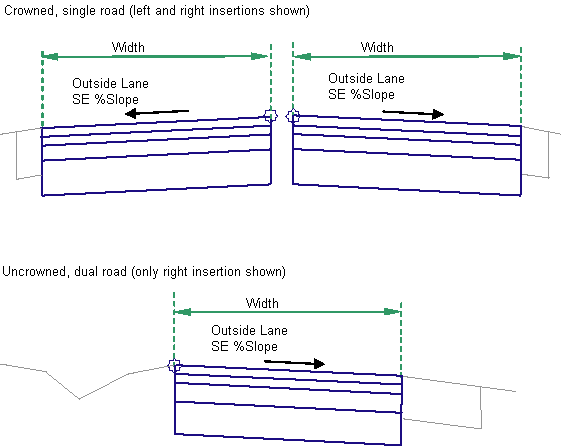

This subassembly creates a cross-sectional representation of a travel lane, applying the Outside Lane superelevation slope value for the corridor model’s baseline alignment.
Note: This subassembly does not support superelevation axis of rotation pivot points other than Centers. This subassembly has been deprecated and is available only in the Corridor Modeling Catalogs. The LaneSuperelevationAOR subassembly has all the functionality of this subassembly, and it supports superelevation axis of rotation pivot points.
It is used for most undivided roads, or divided roads with no lane slope break on either side. It may also be used for the outside lanes of divided crowned or broken-back highways. The pavement structure follows the standards described in “Pavement Structure on Paved Sections” in the AutoCAD Civil 3D Help.
The attachment point is either (a) at the inside edge of lane on finished gradient, if the insertion point is Crown, or (b) at the outside edge of travel way, if the insertion point is at the edge of travel way. This component can be attached to either the left or right side.

The Outside Lane superelevation slope is obtained from the superelevation specifications for the baseline alignment. Starting at the attachment point, a finish surface and parallel subgradient are inserted using the given width, depth, and the superelevation slope. Vertical links close the shape at either end of the lane.
If an offset horizontal alignment name is assigned to the Width during corridor modeling, the width of the lane will vary to match the offset of the alignment.
