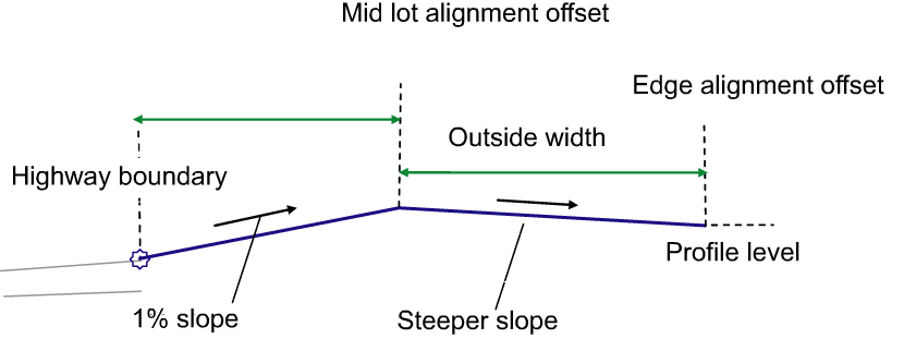

This subassembly is used to grade plots from a highway boundary line.
The following illustration shows an example of this subassembly being used when the target profile level at the back of the plot is higher than the attachment point.

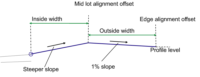

The following illustration shows an example of this subassembly being used when the attachment point is higher than the target profile level at the back of the plot.
