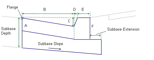

This subassembly inserts links for a slope-bottomed valley kerb and channel with subbase.
The bottom surface of the curve flattens to a horizontal link at the channel invert level. User-defined input parameters control the dimensions of the shape.

Dimension A
Depth of the channel at the flange point
Numeric, positive,
non-zero
150 mm
6 in
Dimension B
Width from the channel flange point to the channel invert level
Numeric, positive,
non-zero
600 mm
24 in
Dimension C
Depth from the channel flange point to the channel invert level, and from the channel invert level to the top-of-kerb
Numeric, positive,
non-zero
50 mm
2 in
Dimension D
Width from the channel invert level to the top-of-kerb
Numeric, positive,
non-zero
40 mm
1.5 in
Dimension E
Width from the top-of-kerb to back-of-kerb
Numeric, positive,
non-zero
150 mm
6 in
Dimension F
Height of the back-of-kerb
Numeric, positive,
non-zero
300 mm
12 in
Behavior
The kerb and channel links are inserted based on the Input Parameter values for Dimension A – Dimension F. All dimensions must be positive, non-zero values. If a non-zero subbase depth is given, the subbase layer is inserted to the back of kerb, and continues for the Subbase Extension width. The subbase layer closes to the bottom-back-of-kerb, as shown in the diagram.
