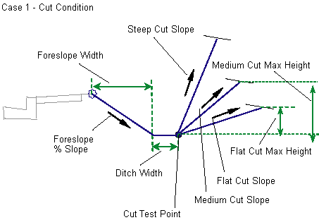

Flat Cut Slope
First, flattest, catch slope to attempt. (x : 1)
Numeric, positive
6 ( : 1)
Flat Cut Max Height
Maximum allowable height of the closing link using the Flat Cut Slope
Numeric
1.5 m
5 ft
Medium Cut Slope
Cut slope to attempt if the Flat Cut Slope link exceeds the Flat Cut Max Height
Numeric, positive
4 ( : 1)
Medium Cut Max Height
Maximum allowable height of the closing link using the Medium Cut Slope
Numeric
3 m
10 ft
Steep Cut Slope
Cut slope to use if the Medium Cut Slope link exceeds the Medium Cut Max Height
Numeric, positive
2 ( : 1)
Foreslope Width
For cut sections, the width of the front-of-ditch link
Numeric
3.6 m
12 ft
Foreslope Slope
Slope of the front-of-ditch link (x : 1). This link is always inserted downwards.
Numeric, positive
4 ( : 1)
Ditch Width
Width of the bottom of ditch. Use zero for a V-ditch.
Numeric, positive
1 m
3 ft

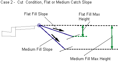

Flat Fill Slope
Numeric, positive
6 ( : 1)
Flat Fill Max Height
Maximum allowable height of the closing link using the Flat Fill Slope
Numeric
1.5 m
5 ft
Medium Fill Slope
Fill slope to attempt if the Flat Fill Slope link exceeds the Flat Fill Max Height
Numeric, positive
4 ( : 1)
Medium Fill Max Height
Maximum allowable height of the closing link using the Medium Fill Slope
Numeric
3 m
10 ft
Steep Fill Slope
Fill slope to use if the Medium Fill Slope link exceeds the Medium Fill Max Height
Numeric, positive
2 ( : 1)

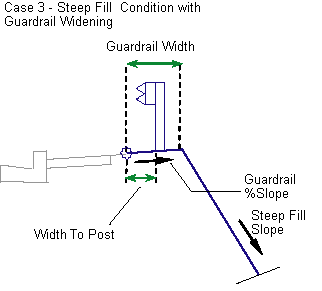

Guardrail Width
Width of the guardrail widening link for fill slopes using Steep Fill Slope. Use zero for no guardrail widening.
Numeric, positive
0.6 m
2 ft
Guardrail %Slope
% slope of the guardrail widening link
Numeric
-2 (%)

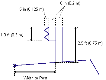

Include Guardrail
Omit Guardrail
Include to insert the guardrail structure when guardrail widening occurs. Omit does not insert the guardrail structure.
Include / Omit
Omit
Width to Post
When the guardrail is included, the width from the attachment point to the inside edge of the guardrail post.
Numeric
0.3 m
1 ft

The following steps are used by this subassembly to determine which conditions apply:

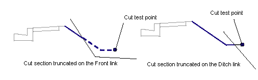

  1. The location of the Cut Test Point (see diagram) is calculated using the Foreslope Width, Foreslope Slope, and Ditch Width parameters.
  2. If any portion of the foreslope slope or ditch bottom is in cut, the section is computed as a cut section as follows:
    • If the Cut Test Point is above the target surface, the Foreslope link or ditch bottom is truncated at the point where it intersects the surface going from cut to fill, otherwise:
    • If Include Daylight Link is set to omit, no daylight link is calculated.
    • The intercept to the target surface is calculated using the Flat Cut Slope value.
    • If the height of the flat cut slope exceeds the Flat Cut Max Height, the intercept to the target surface is re-calculated using the Medium Cut Slope value.
    • If the height of the medium cut slope exceeds the Medium Cut Max Height, the intercept to the target surface is re-calculated using the Steep Cut Slope value.
  3. If no portion of the foreslope link or ditch bottom is below the target surface, the section is computed as a Fill section as follows:
    • The intercept to the target surface is calculated using the Flat Fill Slope value.
    • If the height of the flat fill slope exceeds the Flat Fill Max Height, the intercept to the target surface is re-calculated using the Medium Fill Slope value.
    • If the height of the medium fill slope exceeds the Medium Fill Max Height, the guardrail widening link is added to the assembly using the Guardrail Width and Guardrail %Slope parameters (unless the Guardrail Width is zero). The intercept to the target surface is re-calculated from the outside edge of the guardrail widening link using the Steep Fill Slope value.
    • If Include Daylight Link is True, the flat, medium, or steep fill slope link is added to the assembly.
A guardrail structure may be applied to fill sections that meet the criteria for using the steep fill slope. If this criteria is met, the Guardrail Width is not zero, and Include Guardrail is set to true, then a guardrail structure is drawn at the chainage. The dimensions of the guardrail structure are fixed as shown in the diagram below.

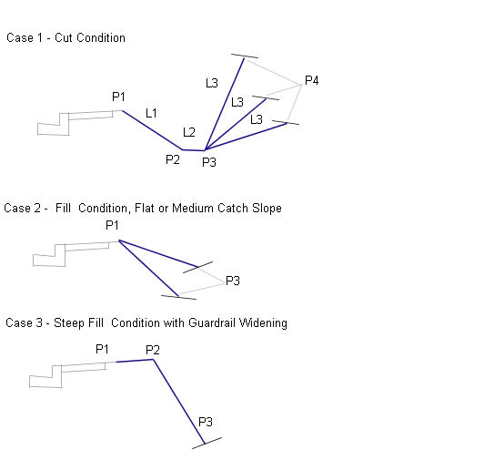

Point, Link, and Shape Codes
The following table lists the point, link, and shape codes for this subassembly that have codes assigned to them. Point, link, or shape codes for this subassembly that do not have codes assigned are not included in this table.
Point, Link, or Shape
Code
Description
P1
Hinge
Hinge_Fill
Hinge point for the normal fill condition
P2
Hinge
Hinge_Fill
Hinge point for the fill condition with guardrail widening
P2
Ditch_In
Inside edge of the bottom of the ditch (cut condition only)
P3
Ditch_Out
Hinge
Hinge_Cut
Outside edge of the bottom of the ditch (cut condition only)
P3
Daylight
Daylight_Fill
Fill slope stake point (fill condition only)
P4
Daylight
Daylight_Cut
Cut slope stake point (cut condition only)
All Links
Top
Datum
All links added by this subassembly, except for the guardrail structure links.
Guardrail points
None
No codes are assigned to the points on the guardrail structure, if included.
Guardrail links
Guardrail
All links comprising the guardrail structure, if included.
L3
Top
Datum
Daylight
Daylight_Cut
Daylight link for cut section
Fill Daylight Link
Top
Datum
Daylight
Daylight_Fill
Daylight link for fill section
Coding Diagram
