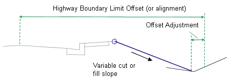

This subassembly inserts a daylight link from the attachment point to a given offset from the highway boundary limit on a target surface.
You can also specify optional lined materials for daylight and other links (All Links, Daylight Links, Fill Links Only, and None).
The attachment point is at the inside edge of the daylight link.

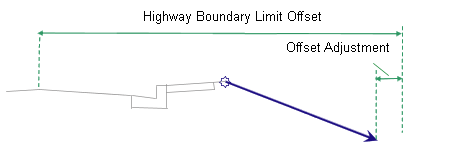

Offset Adjustment |
+/- value added to the HB Limit Offset. A negative adjustment value moves the daylight point inside of the HB limit; a positive value moves it outside the HB limit. |
Numeric |
0.0 |

The daylight offset is calculated as the HB Limit Offset plus or minus the Offset Adjustment. A daylight link is inserted from the attachment point to the calculated offset on the target surface.

In layout mode, this subassembly displays a link extending outwards at a -4 : 1 slope to the highway boundary offset, plus or minus the offset adjustment. The daylight link terminates with an arrowhead pointing outwards.
