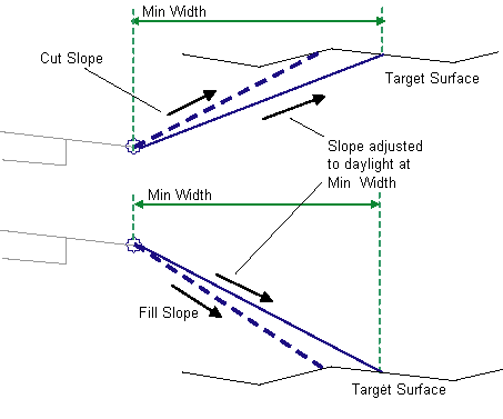

This subassembly inserts a link that daylights to a target surface at a user-defined cut or fill slope.
If necessary, the slope is adjusted to keep the daylight point beyond a minimum width from the hinge point.

This subassembly attempts to calculate a daylight point for the cut condition. If a daylight point is found, the width of the daylight link is compared to the Min Width value. If the daylight point is within the Min Width, the daylight point is moved to the minimum width point on the target surface. If no cut daylight point is found, the process is repeated for the fill condition.

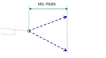

In layout mode, this subassembly displays both the cut and fill slopes in dashed lines extended outward for the Min Width distance. The daylight links are terminated with arrowheads pointing outwards.
