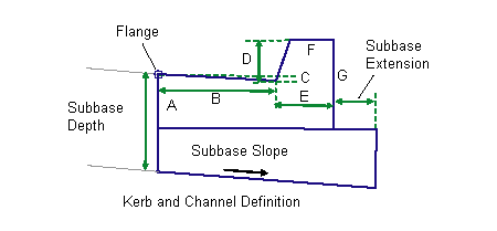

  The following are the same parameters as KerbAndChannelGeneral subassembly.
Subbase Depth
Depth to subbase at the flange point. Use zero if there is no subbase.
Numeric, positive
0.450 m
1.5 ft
Subbase Extension
Distance the subbase is extended beyond the back-of-kerb. Use zero to terminate the subbase at the back-of-kerb.
Numeric, positive
0.3 m
1 ft
Subbase Slope Method
Selects whether to use the Outside Lane superelevation slope for the subbase layer, or to set a numeric % slope value
Selection list
Fixed Slope
Subbase %Slope
% slope of the subbase layer. Not used if Use SE is set to True.
Numeric
-2 (%)
Dimension A
(mm/in)
Depth of the channel at the flange point.
Numeric, positive,
non-zero
175 mm
6 in
Dimension B
(mm/in)
Width from the flange point to the channel invert level.
400 mm
16 in
Dimension C
(mm/in)
Depth from the flange point to the channel invert level.
Numeric, positive,
non-zero
25 mm
1 in
Dimension D
(mm/in)
Height of kerb from the channel invert level to the top-of-kerb.
Numeric, positive,
non-zero
150 mm
6 in
Dimension E
(mm/in)
Width from the channel invert level to the back-of-kerb.
Numeric, positive,
non-zero
200 mm
8 in
Dimension F
(mm/in)
Width of the top-of-kerb.
Numeric, positive,
non-zero
150 mm
6 in
Dimension G
(mm/in)
Height of the back-of-kerb.
Numeric, positive,
non-zero
325 mm
13 in

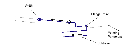

This subassembly is used to place a new kerb and channel parametrically, and can optionally tie (with a sod strip) into either the inside edge of the existing footpath, or to a new footpath created with another subasembly. The horizontal placement of the kerb and channel is determined from the previously known flange point location. Highside of the sod strip can be located either by a fixed offset or any other marked point, such as the inside edge of footpath. Alternatively, this point can come from target parameters of an aligment and profile. Newly designed flange point, optionally marked so that it can be used as input later for replacement lane subassemblies.
Key steps in completing this conditional subassembly are as follows:
  1. Get existing pavement level at the flange point offset.
  2. Set flange point level based on the minimum lift value.
  3. Next insert kerb and channel points from P to P4 using the input parameters (similar to KerbAndChannelGeneral).
  4. If the inside footpath marked point is assigned, establish that point as P10. If marked point is not associated, look for target parameters for 'inside edge of footpath" alignment. If yes, then get profile level from the surface target parameter.
  5. If none of the above data is available for the highside of the sod strip, use the offset as dictated by attachment point to establish point P10.
  6. Find the slope between P4 and P10.
  7. Check whether that slope is within the parameters of Min/Max sod strip slopes.
  8. If it is lower than minimum, set the slope to minimum allowable and computed points P4 to P1 backwards. Similarly, if the slope is more than maximum allowable sod strip slopes, set it to maximum allowable and calculate P4 to P1.
  9. Check whether the level difference between P1 and P11 is within tolerable limits of max milling. If P is below P11 and difference is more than max milling, then abort, resulting in an error displayed in the event viewer.
All other kerb and channel links are inserted, based on the Input Parameter dimensions Dimension A - Dimension F. All dimensions must be positive, non-zero values. If a non-zero subbase depth is given, the subbase layer is inserted to the back of kerb, and continues for the Subbase Extension width. The subbase layer closes to the bottom-back-of-kerb as shown in the diagram.
Layout Mode Operation
In layout mode , this subassembly is set based on the attachment point and the default flange point offset from baseline. The width of the sod strip is computed by subtracting the kerb and channel total widt from "flange point to attacment point" distance. The minimum allowable sod strip slope is used to calculate the back of kerb point from which the rest of the kerb and channel is drawn, using the input parameters given.
