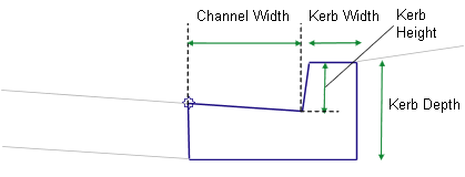

The attachment point is at the flange point of the channel or back of the kerb.

Channel Width
Width from the flange of the channel to the invert level
Numeric, positive
0.45 m
1.5 ft
Channel %Slope
% slope of the channel
Numeric
-6%
Kerb Height
Height from the invert level to the top of kerb
Numeric, positive
0.225 m
0.75 ft
Kerb Width
Width of the top of kerb
Numeric, positive
0.15 m
0.5 ft
Kerb Depth
Depth from the top of kerb to the bottom of kerb at the back-of-kerb point
Numeric, positive
0.45 m
1.5 ft

The subassembly builds the shape for a simple kerb and channel with the attachment point either at (a) the inside edge of the channel (or lip), or (b) the back of the kerb. The face of the kerb is given a small, constant width to make it non-vertical.
