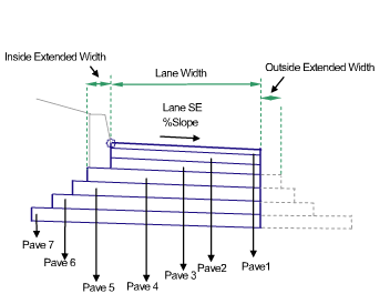

Each layer has its own separate extension options both on the inside and outside. The inside and outside extensions specify the additional width on the inside or outside relative to the pavement layer immediately above.

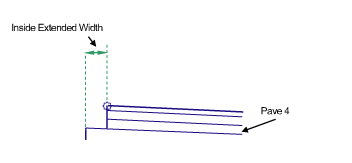

In the following example, the Pave4 Inside Extended Width is 0.5 meters. The Pave4 Outside Extended Width is zero. If this subassembly is inserted on the right side, it is drawn as shown in the following illustration.

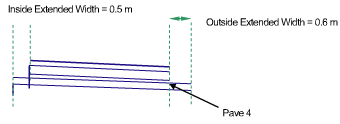

In the following example, the Pave4 Inside Extended Width is 0.5 meters. The Pave4 Outside Extended Width is 0.6 meters. If this subassembly is inserted on the right side, it is drawn as shown in the following illustration.
The extension widths will always be specified as positive widths.
