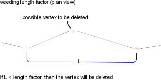

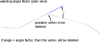

Vertices are weeded if found to be unnecessary for line location, based on weeding factors of angle, gradient, length, and 3D distance. Points selected for weeding are highlighted in red.
The weeding factors delete vertices that:
Larger factors weed more vertices.
You can choose which factors you want to be used to calculate the weeding. For example, if you only want to apply a length factor, select the Length check box and specify a length, and clear all other check boxes.
