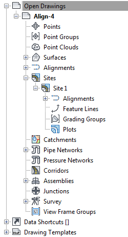

On this tab, all of the objects in a drawing or project are arranged in a hierarchy.
The Prospector tree contains the following top-level collections, which can be viewed using the Master View:
Use the drop-down list at the top of the Prospector tab to control which items are displayed in the Prospector tree.
Use the Prospector tree to manage and access drawing and project objects.
The following illustration shows an expanded Prospector tree for a drawing:
