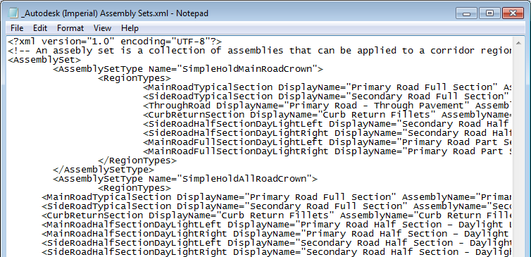

| assembly set file | An .xml file containing information that defines the assemblies that are included in an assembly set. An assembly set file contains the names of the assembly objects, the location (path) where the individual assembly drawings exist, and other information about the assemblies included in the set. This .xml file serves primarily as a pointer (reference mechanism). It does not contain the actual assembly drawing data. |

The assembly set that is included with AutoCAD Civil 3D is typically located by default in the following location:
C:\ProgramData\Autodesk\C3D <version>\enu\Assemblies\<units>
The following illustration shows the contents of the default assembly set file that is included with AutoCAD Civil 3D.
