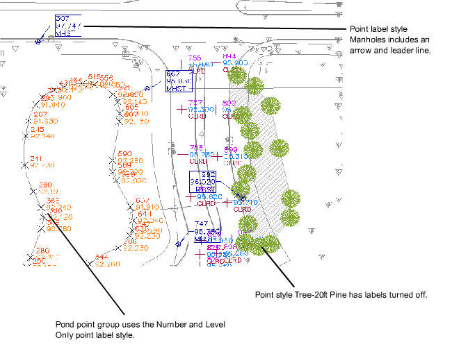

To control the appearance of a point symbol in a drawing, either select a default point symbol, or create a point symbol.
Examples of point label styles
You can automatically label points with predefined labeling criteria as you create points in a drawing.
Use the Point Editor to edit point properties. You can also use AutoCAD commands to edit points graphically.

When you create or import points, you can use description keys to automatically control the appearance of a point in the drawing based on its raw (field) description.
You can group related points into point groups using a variety of criteria. You can use point groups to control the appearance of points in a drawing, to create surfaces, or to export selected points to a file.
