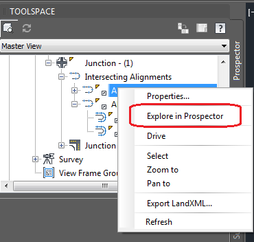

Another feature available from the Intersecting Alignments collection is the Explore In Prospector command.
To use this command, right-click an alignment in the Intersecting Alignments collection, and select Explore In Prospector.

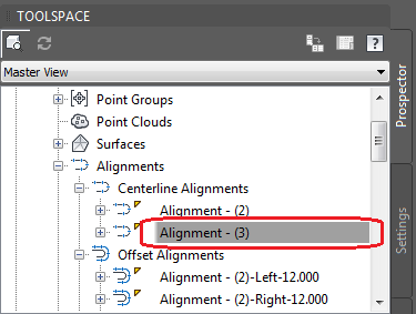

The same alignment is automatically displayed and selected in under the Alignments
Centerline Alignments collection of the Prospector tree. Use this command to quickly find the location of an intersecting alignment in the Prospector tree.
