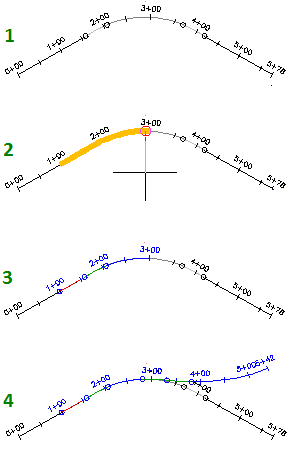

Select a source alignment (1), and then specify a range of chainages (2) to create an alignment (3). Add sub-elements onto the new alignment (4) to create an alignment that merges into or exits from the source alignment.

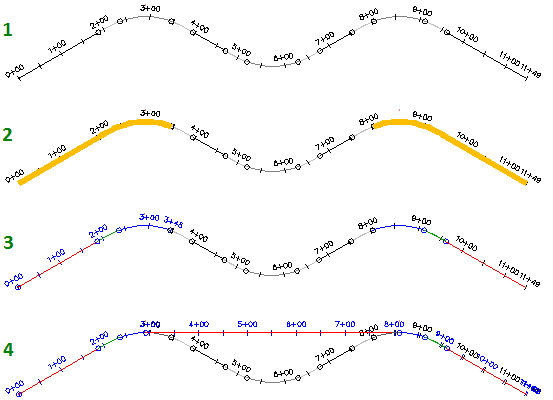

Select a source alignment (1), and then specify sub-elements (2) from which to create an alignment (3). Add sub-elements onto the new alignment (4) to create an alternative design that is based on the source alignment.
