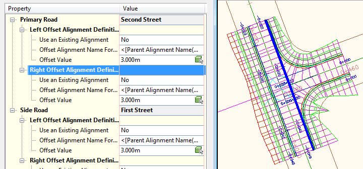

Object Highlighting in Drawing: When you select some items on a junction editing dialog box, the affected object is highlighted in the drawing. For example, when you select an offset on the Junction Offset Parameters dialog box, that offset alignment is highlighted in the drawing. This behavior is displayed in the following illustration.
The right side offset alignment named First Street is selected in the Junction Offset parameters dialog box, shown on the left. In the drawing, that offset alignment is highlighted.

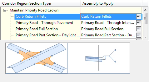

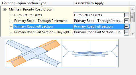

Conceptual Graphics on Dialog Boxes: Each time you select a property or item to edit on junction editing dialog boxes, the conceptual graphic is displayed at the bottom of the editing dialog box updates to indicate the location along the junction affected by the edit.
For example, when you select the “Primary Road Full Section” corridor region on a junction editing dialog box, the following conceptual graphic is displayed, indicating the location of this region along the corridor.
Similarly, when you select the “Primary Road Full Section” corridor region

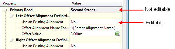

Shading of Non-editable Properties: In editing dialog boxes, properties that are not editable are displayed with a gray (shaded) background color. Properties that are editable are displayed with a white (not shaded) background color.
