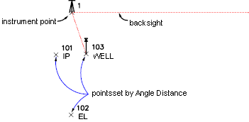

This example creates point 103, which is located by turning a horizontal angle of 80°20'40" right at a distance of 100 units from the instrument point with the description WELL. Because no method of vertical difference determination was given, the level is <Null>.

This example creates point 101, which is located by turning a horizontal angle of 100°20'45" right from the backsight and using a vertical angle of 91°15'15" at a distance of 100 units from the instrument point with the description IP.
AD VA 101 100.2045 100 91.1515 IP
This example creates point 102, which is located by turning a horizontal angle of 90°30'30" right from the backsight and using a vertical distance of -1.5 units at a distance of 200 units from the instrument point with the description EL.
AD VD 102 90.3030 200 -1.5 EL
Points created with the angle distance command:
Point 101 is located by turning a horizontal angle of 100°20'45" right from the backsight and using a vertical angle of 91°15'15" at a distance of 100 units from the instrument point with the description IP.
Point 102 is located by turning a horizontal angle of 90°30'30" right from the backsight and using a vertical distance of -1.5 units at a distance of 200 units from the instrument point with the description EL.
Point 103 is located by turning a horizontal angle of 80°20'40" right at a distance of 100 units from the instrument point with the description WELL. Because no method of vertical difference determination was given, the level is <Null>.
