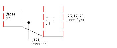

For example, you might have a grading region with a slope of 3:1, and another region with a slope of 2:1, separated by a transition region, in which the grading merges from 3:1 to 2:1. Regions to which criteria have been applied are called control regions.
You are prompted to create a transition region if you specify the start point of a grading region to begin within an existing grading on the same footprint. You can also insert transition regions by using the Grading Creation Tools.
