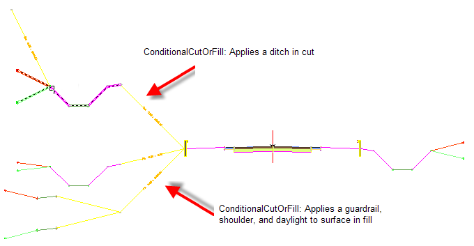

An assembly that contains one or more conditional subassemblies can be referred to as a conditional assembly. When you have a conditional assembly in your drawing, specified subassemblies are automatically applied at chainages when conditions exist.
For example, a conditional corridor assembly could contain two ConditionalCutOrFill subassemblies. The first ConditionalCutOrFill subassembly can be configured to apply a ditch subassembly when a cut condition exists. The second ConditionalCutOrFill subassembly can be configured to apply a guardrail, shoulder, and daylight to surface when a fill condition exists. Using conditional subassemblies enables you to reduce the number of corridor regions and assemblies that you have to maintain.
The following illustration shows an example of an assembly that contains a ConditionalCutOrFill subassembly that is configured to apply a ditch in cut situations, and another ConditionalCutOrFill subassembly that is configured to apply a guardrail, shoulder, and to daylight to surface in fill situations.
