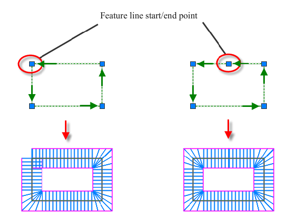

For example, if the feature line starts and ends at a corner, as shown in the following illustration on the left, the corner cleanup does not get applied.
To work around this, it is recommended that you draw the feature line so that it starts and ends at a location other than a corner as shown in the following illustration on the right.
