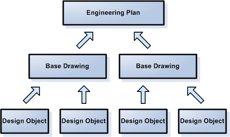

A best practice common to all project structures is to organize individual design objects such as alignments and surfaces in separate drawings. These objects are referenced into base drawings during the design process. Complete engineering plans and final production drawings are prepared with a combination of object references and drawing references.
