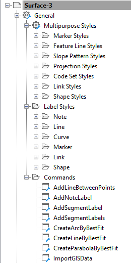

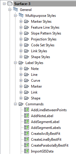

Use the General collection to create multipurpose and label styles that can be used by more than one object type.
Pipes and Surface objects can share the Render styles in the General Multipurpose Styles collection, while Corridors and Grading share the other styles in this folder.
The General Label Styles are used by lines, curves, feature lines, and corridors. This collection also contains Note label styles, which are not specific to an object.
The following illustration shows an illustration of the General collection:
