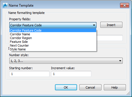

In addition to the Style Name and Next Counter properties, you can specify several properties for feature line names which help to identify them in relation to the parent corridor, including Corridor Feature Code, Corridor Name, Corridor Region, and Feature Side.
You can access this dialog box from the Extract Corridor Feature Line Settings dialog box.

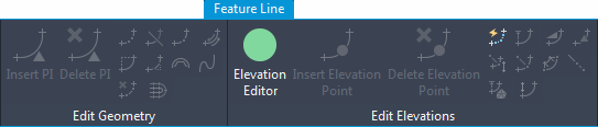

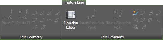

When a feature line is dynamically linked to a corridor, most of the feature line editing commands are not available from the ribbon. The following illustration shows the editing panels on the Feature Line contextual ribbon tab when a dynamic feature line is selected. You can use the Level Editor and the Quick Level Edit command to view data but not edit it.
