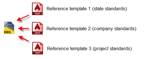

In addition, you can have multiple reference templates attached to a drawing. For example, you might have templates for state, company, and project standards:
You can specify a hierarchy so that the template with the highest priority takes precedence if there are duplicate styles.
