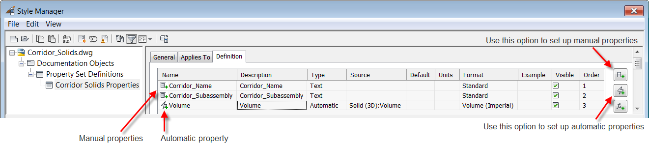

- Define the property set by using the Style Manager.
Create a new property set and set up manual and automatic properties to associate with the objects.
- Manual properties are manually entered for the object. The value entered for a manual property is saved with the object.
- Automatic properties are obtained from the object. For example, the physical characteristics of an object, such as its volume, is an automatic property.

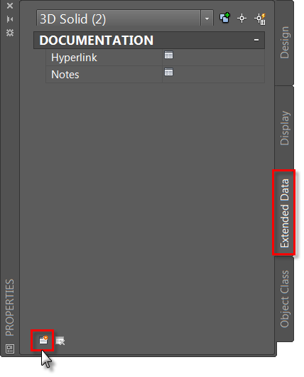

- Select the objects in the drawing and use the AutoCAD Properties Palette to assign the property set to the AutoCAD Civil 3D objects.
Click Add Property Set
on the Extended Data tab of the Properties Palette to assign the property set to selected objects.
