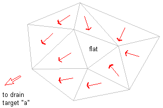

If some of the opposing, non-flat triangles slope down from the flat area boundary, but all flow to the same drain target, then the flat area is part of the watershed for that drain target “a”, as shown in the following illustration:

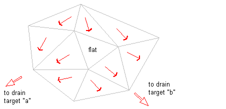

In the following illustration, the flat area, plus whatever part of the surface flows down to it, becomes a flat area watershed. This watershed is ambiguous because water flowing through it can flow to more than one drain target, “a” and “b”:
