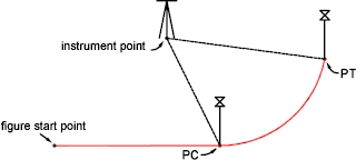

Specify that the next shot is a Point of Curvature (PC) in the current figure. The shot immediately following the next shot is on the Tangent Point (TP). This command creates a straight arc from the last leg in the figure.
Survey Command Window. PC
PC
AD 13 30 25 ! Shot on PC
AD 14 33 24 ! Shot on TP
END
The following illustrates the Point of Curvature command:
PC
