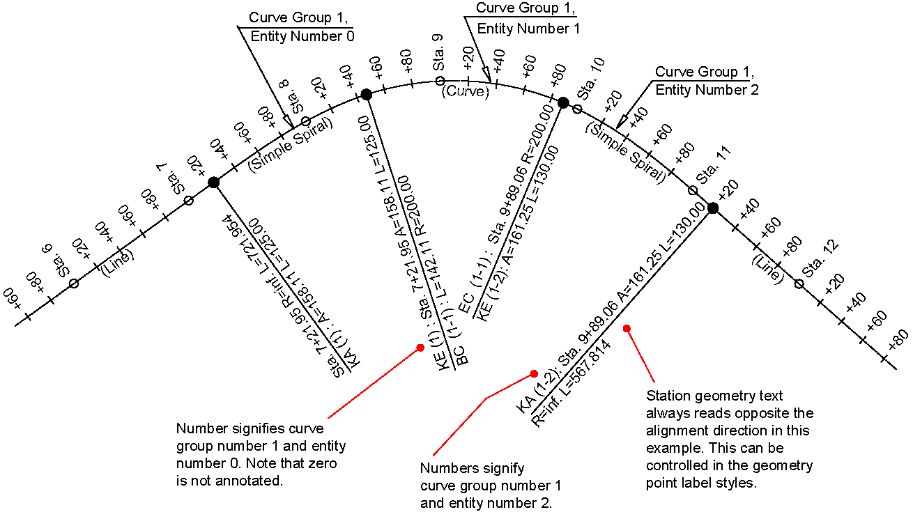

When you create alignments, they are labeled automatically with the labels specified in the Alignment Labels dialog box. The labels are applied along the alignment at specific points, for example, the major and minor chainages.
With the Add Labels command, you specify the following parameters as you label the alignment:
You can also use commands to insert alignment tables into a drawing. Alignment tables organize and consolidate the information about the alignment. When you insert a table into the drawing, full labels are converted to tags, and the detailed alignment information is inserted into the table.
