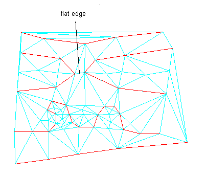

When contour data is added to a Triangulation surface, the resulting surface can contain flat spots (triangles whose points all come from the same contour) and flat edges (triangle edges that join points from the same contour or from different contours at the same level).
The following illustration shows a surface with flat areas where the triangles (in cyan) of a surface are created from red contour lines. Some of the flat triangles and flat edges are indicated:
These flat areas represent inaccuracies in the surface. When the contours of such a surface are displayed, they might not match the original contour data around the flat areas. Also, displayed contours might contain points with three contour segments emanating from them instead of the expected two segments. Use the Minimize Flat Areas operation to find and eliminate triangles that have three points at the same level and edges that connect points on different data contours at the same level.

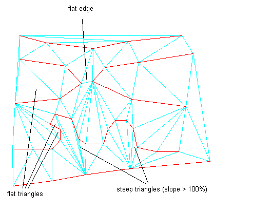

This option scans the surface looking for a flat triangle that shares a non-contour edge with a non-flat triangle. If the two triangles form a convex quadrilateral, the common edge is swapped, creating two non-flat triangles. This may result in other flat triangles sharing non-contour edges with non-flat triangles, and these edges are swapped if possible. The process continues until no more swapping is possible.

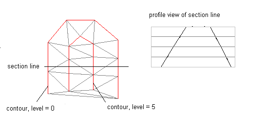

The following illustration shows a surface generated for a ridge where an open contour ends near the border of the surface but not on the border. The contours were added to the surface model with no Minimize Flat Areas. By options specified:

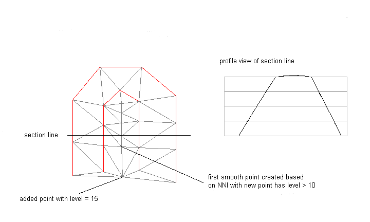

If you run the Minimize Flat Areas operation with the Adding Points to Flat Triangle Edgesoption, the following results are obtained:
These results occur because the NNI interpolation uses surrounding points to determine an appropriate level for a new point. Because all surrounding levels are lower than the flat triangle, levels lower than the flat triangle are selected for the added points, resulting in the dip in the ridge.
In this instance, you can supplement the contour data by adding a spot level point near the open end of the contour, as shown in the following illustration. Then, the Minimize Flat Areas operation generates a crown as desired.
