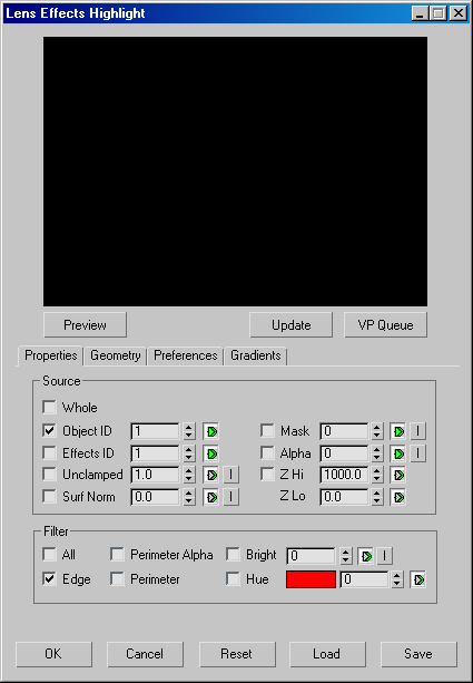

When you select Lens Effects Highlight from the Image Filter Event drop-down list and click Setup, 3ds Max opens the Highlight dialog.
The Lens Effects Highlight interface is almost identical to the Glow interface, with a large preview window, and tabs to control every aspect of your highlight effects.
Similar to the Glow settings, Highlight is also broken down into tabbed sections for fine control over each aspect of the Highlight effect. The four tabs are:
